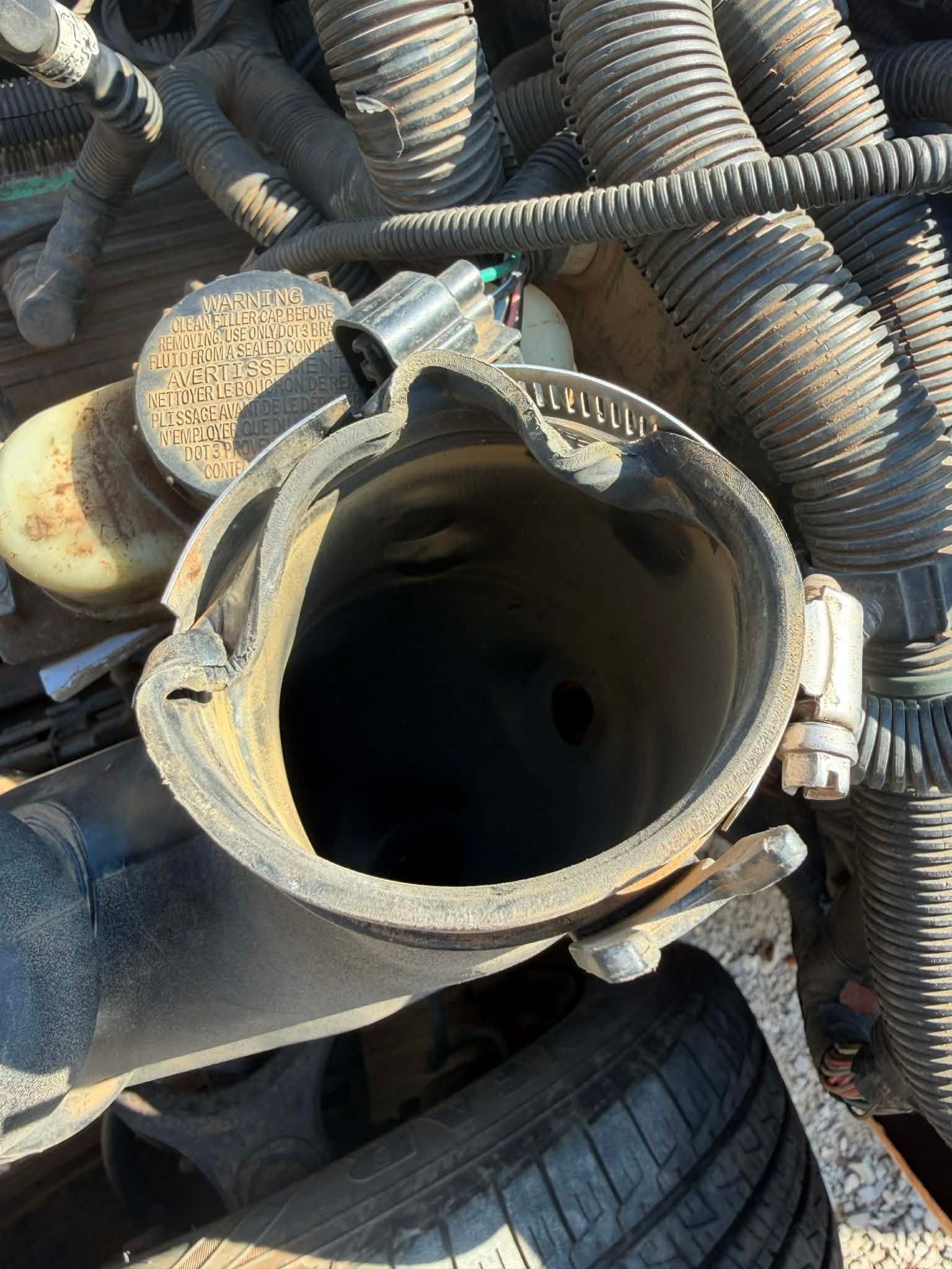

Submission by William Avila for potential fueling issue cause. CHECK YOUR INTAKE TUBE. This causes un metered air to get into the engine causing all sorts of fueling issues. Check for cracks in the bellow boot area and any holes between the air flow sensor and throttle body.
