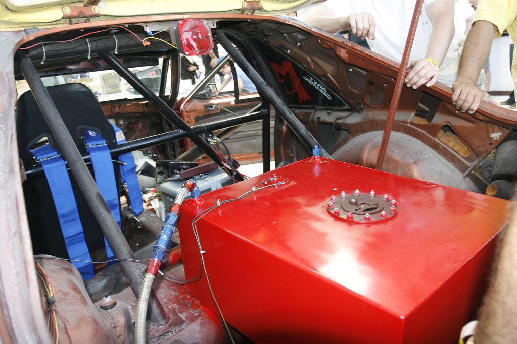

Submission by John. If the cell is not an FIA certified rubber bladder cell (Fuel Safe or ATL) then it must have a sealed metal barrier between it and the driver, even if it is in a metal can. NO EXCEPTIONS! This means most cells from Jazz, RCI, Summit, Etc. They all need a metal bulk head between the cell and the driver. If it is FIA-certified, make sure it has the FIA stamp or you will be making a firewall. A fuel cell install is always judged by its quality of install and is looked at by the race manager, The bar is high, do a good job.
